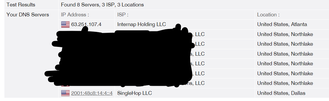

It looks like my yesterday's happiness was short-lived. :(
Here are the new Brave tests today.
From https://www.dnsleaktest.com/results.html
It shows only(!) my ISP DNS. Nothing to do with HideAway. :cry
DNS test.png (47.22 KiB) Viewed 12798 times

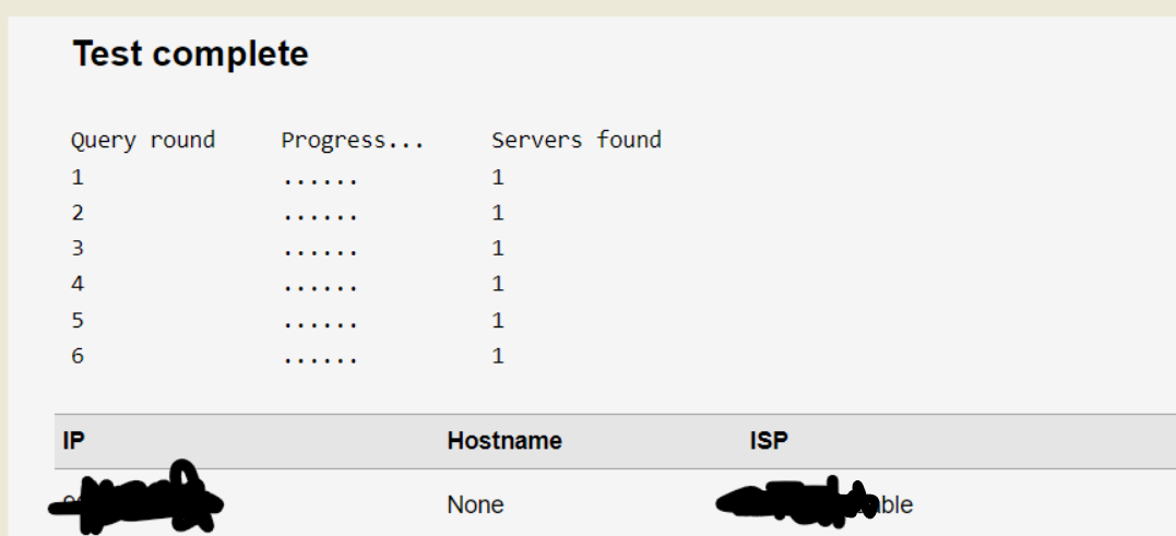

Here is my Brave test from https://browserleaks.com/dns
DNS test-2.png (38.02 KiB) Viewed 12798 times
BBQs
Posts: 29
Joined: Thu Apr 08, 2021 9:43 pm
Re: Brave leaks DNS while using HideAway
Wed May 31, 2023 5:23 am
For me the problem occurred on a couple of sites which showed 'Virgin Media' my ISP while running HideAway - The latest release (4.40.1) has solved the issue on every site I've tried it on - I've tried it on all the 'leak' sites I have.
