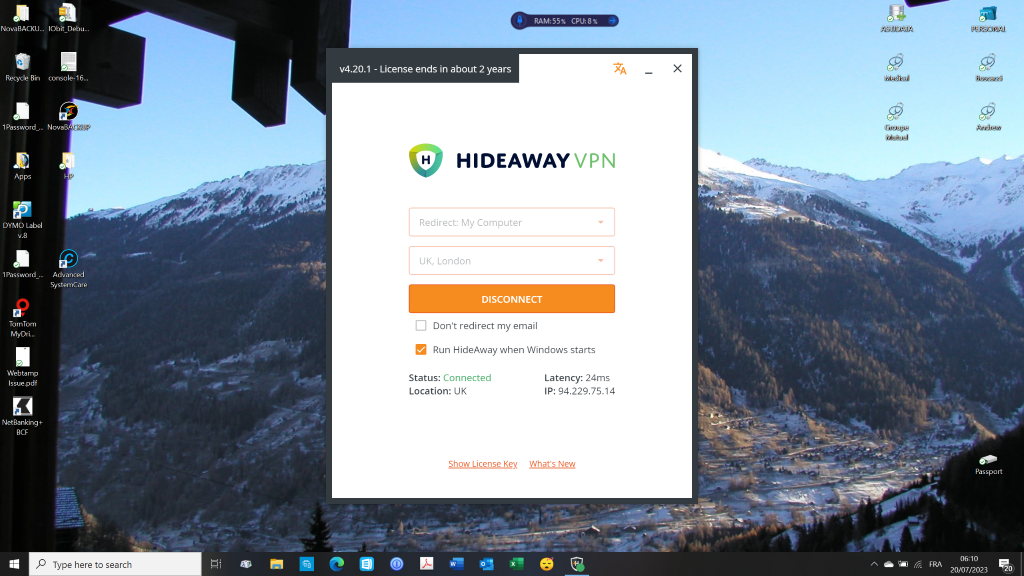

Maybe but it my case it has stopped doing so, see attached screen shot

Not sure that the screenshot attached. Here' another effort:

The problem was screenshot file size. Mine are ±3MB so I had to reduce.
Screenshot (43).png (757.75 KiB) Viewed 13942 times
