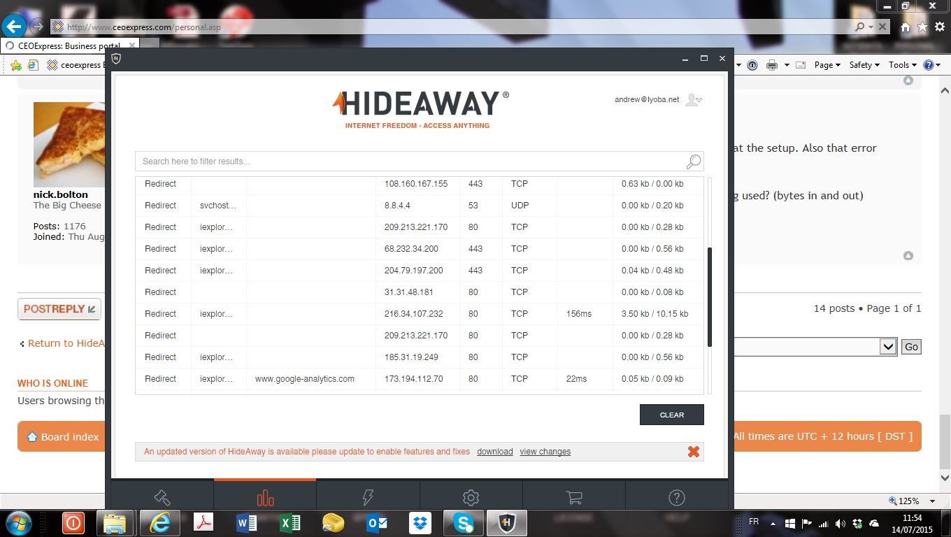

We'll have one of the developers back from illness tomorrow so he'll be able to take a good look at the setup. Also that error message you posted in the other forum post at http://forum.firetrust.com/viewtopic.ph ... 273#p97273
When you use IE, if you go to the Traffic screen, can you see any traffic called iexplore.exe being used? (bytes in and out)

Re: HideAway Not Working
Does this help? I also sent you an email about one hour ago.
- Grimentz Internet Issue.jpg (224.92 KiB) Viewed 16006 times
