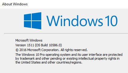

This is what I have if I go to Start>Run, type winver, so I'm unsure about Threshold 2
Ok, I've updated Win 10 first then installed HideAway 1.40 so there must be some differences around that process.

Mon Nov 09, 2015 10:44 pm
You have Threshold 2 👍🏻👌🏻🤓🖖🏻
