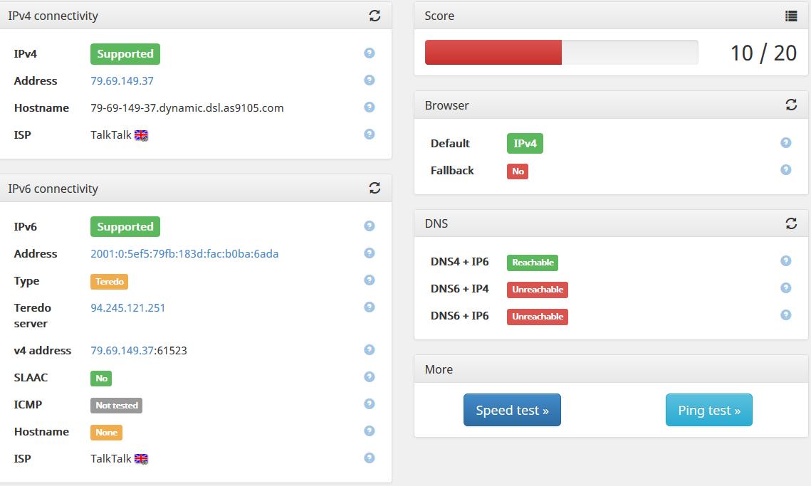

Re: HideAway appears not to be working
Good Morning Nick
please find attached a copy of ipv6test results.
I use Kaspersky Internet Security.
Even with it disable..not even.. loaded the problem still exists.
A quick check using the free version of Ghost6 works fine!
Hi
We've always had problems with Kaspersky, it stops the proper installation of HideAway even if you turn off the protection.
Anyway, assuming it's not that. Can you login in to your Router and turn off IPv6 and see if that helps?
