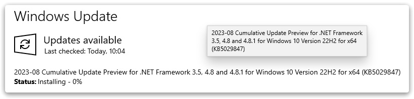

Same
Updated to 173 a few days ago - working fine until now - MW disappeared from the taskbar. Restarting, it checks several accounts and then crashes - consistently.
Win 10 Pro x64 (up to date, but on checking, it installed (without consent!) this .NET update (preview!) - .NET got mentioned in @ucon 's log)
Had to restart PC - no dice.
It's a license issue.
