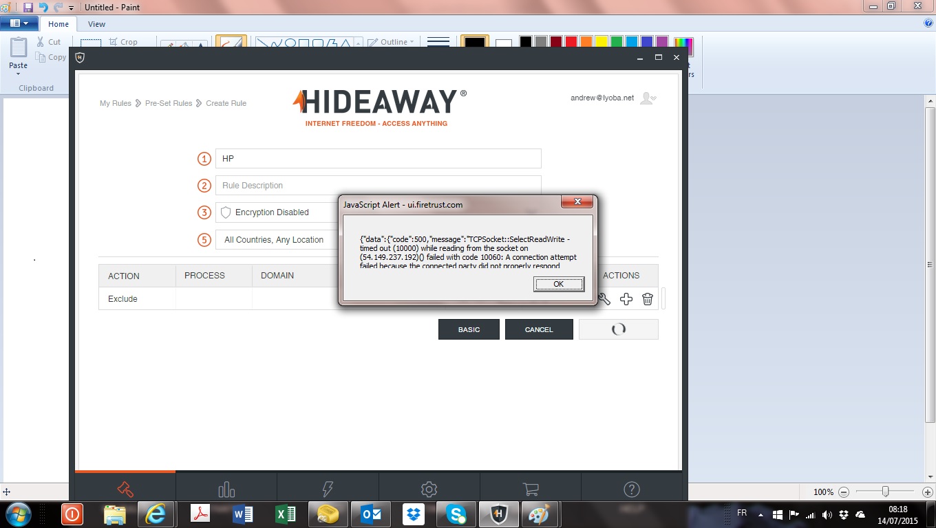

Tried that but got into a catch 22. Because I cannot get HideAway to work at all - see my other post. I cannot add a new rule.
I have taken a screen print of the error message I got when I tried to add the rule. Maybe this will help.
When I get home later today I will add the rule as at Home I was able to connect HideAway. Then I will check with my home printer.
