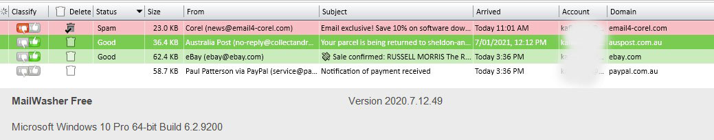

I have had this problem for a while now. Mailwasher rates incoming emails and colours them red if they are probably spam and green if they are probably OK. This is very helpful but a lot of emails are neither red or green which means that I have to individually mark them as spam (so that they turn red). This reduces the value of Mailwasher somewhat. Do I need t6 do something to fix this?

Also if you right click a message >> select Show Evaluation Details >> this will present the sidebar, are these emails showing anything under the Learning ? MailWasher assigns a score, if the email is between -50 to +50, it is considered unsure, so leaves it unclassified.

I have changed the throttle to 500 as you suggest and will see what happens. I clicked Show Evaluation Details afor a red message nd its evaluation was -104. I will do the same to unrated messages if they continue to appear and let you know how they are evaluated.

Changing the throttle to 500 did not help, nor did changing it to 9999. I still get a large number of unrated emails which, I think, are all spam.
