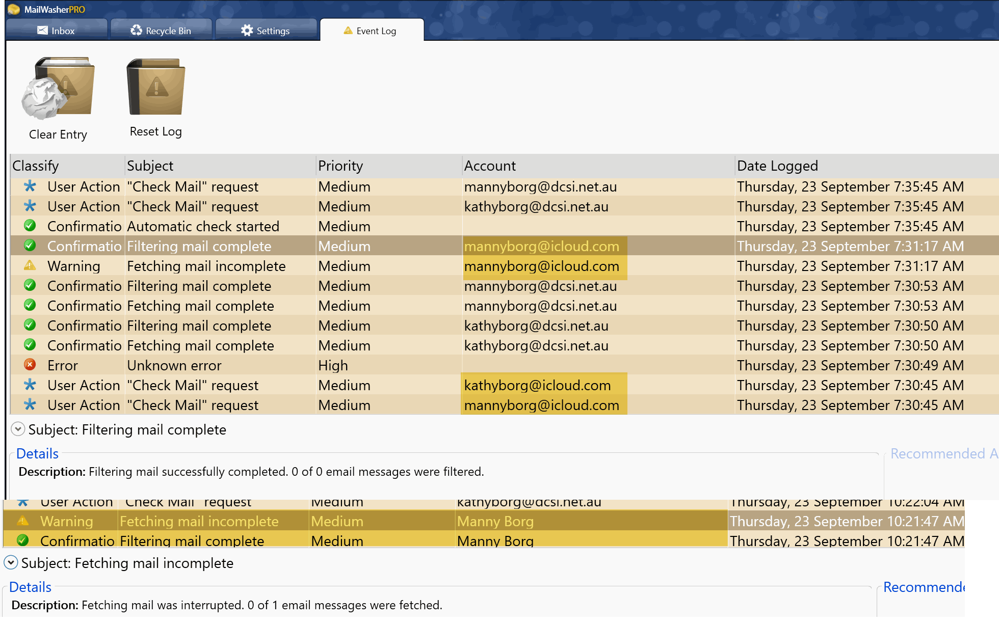

Since 2pm yesterday (22/9/21) Mailwasher is not fetching my Icloud emails. No settings have changed on my PC, have not changed any mailwasher settings. These are the same settings used in my Outlook for ICloud. Just keep getting the following :
Description: An unknown error has occurred. MailWasher is unable to determine the cause of this error.
Diagnosis: <EVENT><NAME>MWPEXCEPTION</NAME><ID>1f8ba12b2cda5a072137b89e5da54a0c</ID><DT>2021-09-23 09:58:10</DT><MWPEXCEPTION><UID>Exception 9e8d81aabfefca78d5c2270160305c60</UID><AID>Acct-494172377</AID><SOURCE>MWPfetch::FetchThread()</SOURCE><MESSAGE>Unknown error</MESSAGE><ADDXML></ADDXML></MWPEXCEPTION><ORDINAL>0</ORDINAL></EVENT>
Attachment shows some of the erros that are occurring;
Mailwasher log.gif (165.76 KiB) Viewed 8740 times
my own Icloud email shows "Check Email" request, then - " An unknown error has occurred. MailWasher is unable to determine the cause of this error."
In regards to the other Icloud email - Mailwasher gets to the filtering mail complete but fails on the Fetching email incomplete.

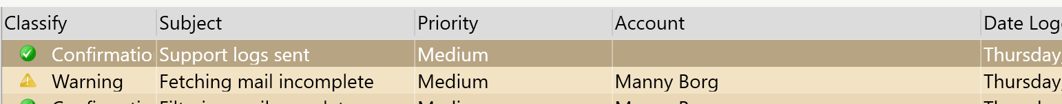

I have sent the logs - interestingly enough via my icloud address which went through but doesn't actually show what account it came from in the MW error log -
Mailwasher 1.gif (16.28 KiB) Viewed 8735 times

OK did what you suggested but didn't help - still getting the error Fetching email incomplete.
However I did notice (if you're really quick) in the bottom lefthand corner where it tells you what MW is doing - it actually states following checking Manny Borg - "Found 1 of 2". Also against my email address it says "Found 4 of 6" which means it's obviously checking what's there but not returning them.

I turned off my Bitdefender so it didn't scan my emails but sadly it still didn't work. :no
I did notice though that when I DON'T have any messages in either of the two Icloud accounts, it doesn't get an error message. It actually says "Filtering Mail Complete" and Fetching Mail Complete"
But as soon as there is actual mail content in the Inbox it gives the error messages
I have also checked my Bitdefender, Outlook, MW and Windows update logs to see if anything had been updated yesterday, but no, nothing that stands out. I can't think what else could have initiated the errors starting yesterday.
