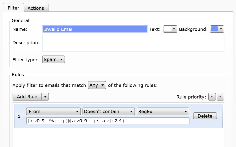

So if they don't have a domain suffix they should be fairly easy to catch.
I use this Custom Filter to look at any email address that shouldn't be considered valid, which would be worth a try. Screenshot attached.
Settings >> Spam Tools >> Filters >> clcik Add Filter >> enter details below, copy/paste the regular expression text.
It's set to if the FROM, DOESN'T CONTAIN, REGEX
Code: Select all
[a-z0-9._%+-]+@[a-z0-9.-]+\.[a-z]{2,4}

Thanks for the input.
I am fairly competent regarding regexes (taught intro classes, etc.) but could not see an obvious way of applying them as part of MW processing. Now that I see how in the MW context, I'm going to be able to do all sorts of screening that was heretofore impossible. Yay!
