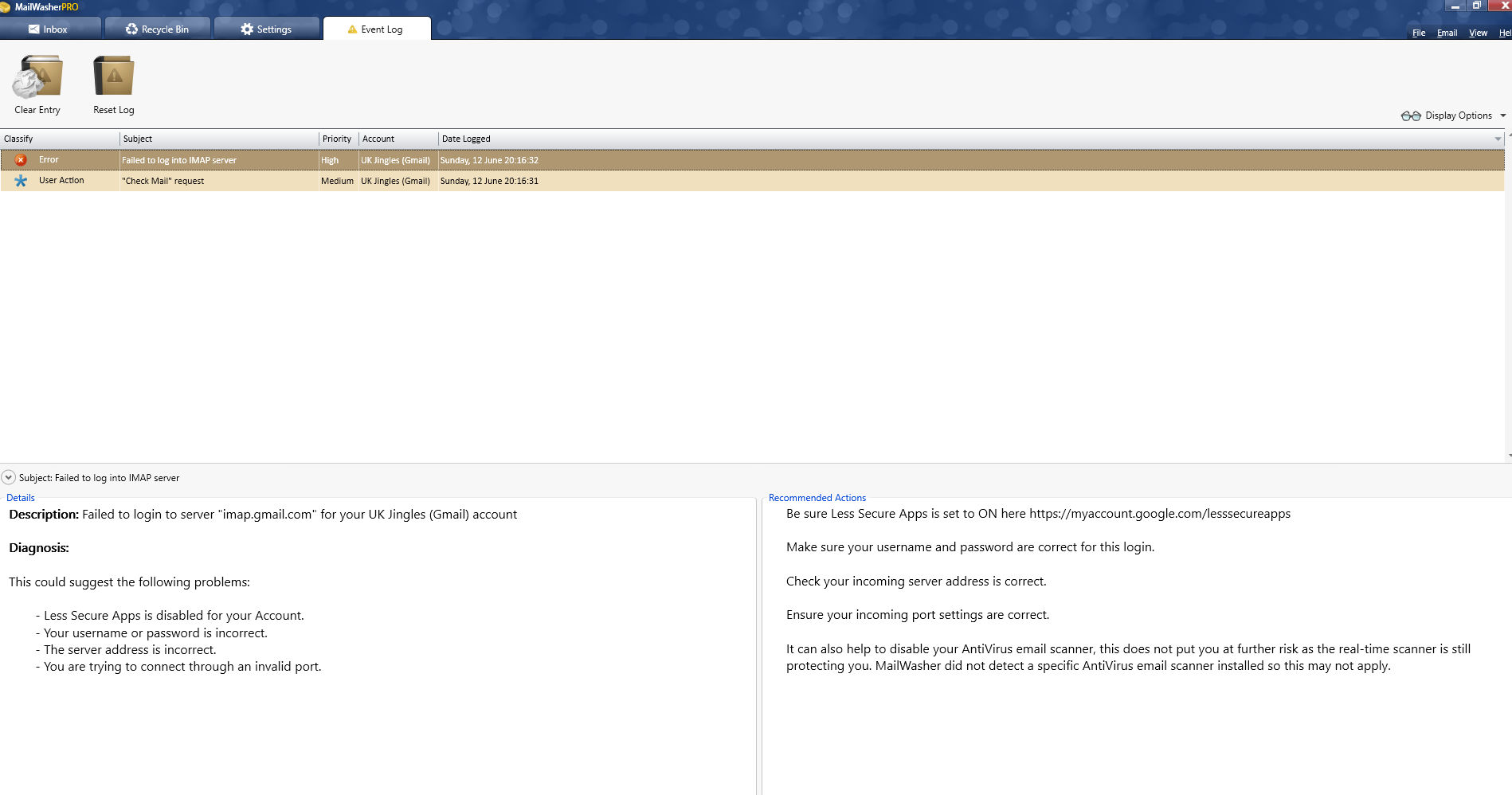

In the last week or so I've been getting this error log when trying to download emails from my GMail account as they have now removed the option for less secure apps..
I've tried resetting password with their 2-step verification and App Password features but still the same......

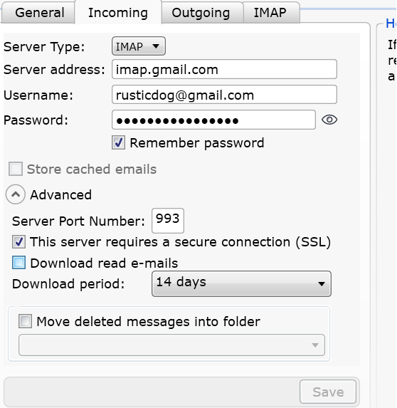

There's no bug we are aware of. When the Less Secure Apps option is removed, you need to use the App Password in MailWasher.
Here's my settings, so you can check if anything is different.

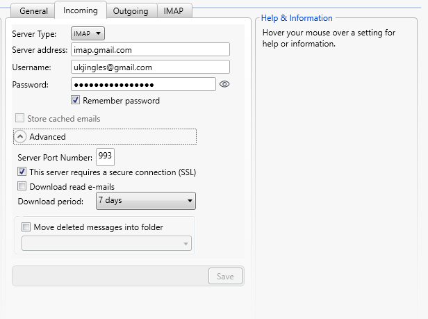

Yes mine is similar (Just 7 days instead of 14 days)
