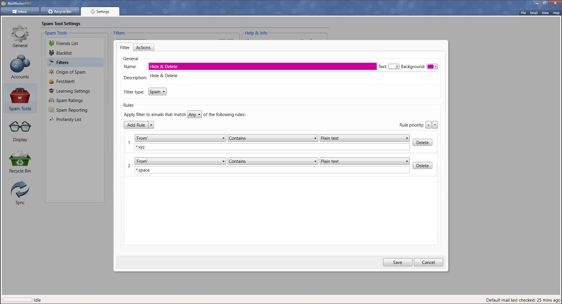

Thanks for the help. Added attached.
I have also moved the filter to the top of the priority list, not that that helps...
I am sure I am missing a step but I just can't see it.

- Filter.png (139.28 KiB) Viewed 4043 times

HOLD YOUR HORSES!!
I changed the *.xyz (where * is a wildcard) to just .xyz - and something happened!
Opened MW to see a fleeting Spam email flushed away - AutoDelete.

Re: Hide & Delete Spam Filter not working*
Great, glad you got it sorted.
The filters don't work the same way as the blacklist/friendslists for wildcards, instead they act greedy.
For example, if you have a filter just looking for the word ted then it would match if a word was stedfast.
When you need to use a wildcard, you then need to use the regular expression format, which can take some learning.
Just to note, as you have done when filtering for a domain, keeping the fullstop helps. Filtering for .space in the FROM, not just space would make sure people with space in their name wouldn't get tagged.
