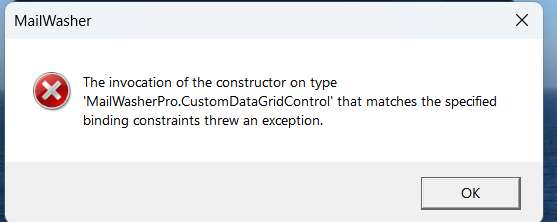

Re: New error on update
I have the same issue and tried what was suggested but I still get the same error and Mailwasher shuts down and as at the moment i cannot use Mailwasher at all, comes up with an error message I have attached.
If you got the 7.15.7 beta and the issue is still occurring, likely this is a different problem...
This 'usually' only occurs when your PC crashes, or has a power cut and MW is shut down expectantly and has no time to save its files, which can cause some file corruption.
Can you please try this first.
Ensure MWpro is closed.
Go to Start, type run (then click the Run file so it runs) then in the ‘Open:’ box type (or copy / paste):
%AppData%\Firetrust\MailWasher
Delete the Startup.xml file and restart Mailwasher....?
If no better, you'll need to do the below please:
(NOTE: this will reset MW to factory settings, you will need to re-enter all your accounts, lists and filters etc into MWPro, Backup directions below if you wish to do this first)
Can you please uninstall, click NO when asked to save your user data, then browse to the following folders (IF there) and delete the contents:
C:\Program Files\Firetrust
C:\Program Files (x86)\FireTrust
C:\ProgramData\Firetrust
(The last folder is actually hidden, so you may need to enable Windows to show hidden files and folders under,
the Windows Control Panel, Folder Options>>View Tab>>Select, Show hidden files and folders.)
Then try reinstalling MWpro.
To Backup, you just need to save all files from the Help>>User Files folder, (OR backup via File>>Export), or if MW wont start, this folder is under:
C:\Users\[username]\AppData\Roaming\Firetrust\MailWasher
(This folder is actually hidden, so you may need to enable Windows to show hidden files and folders under,

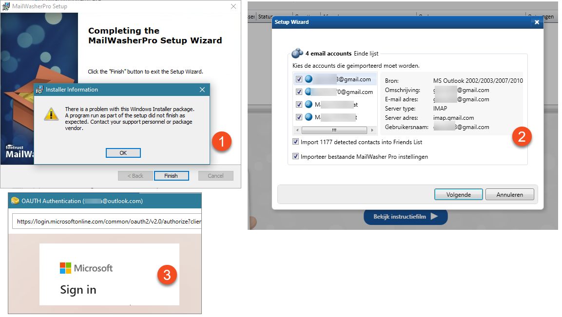

Problem with installer package - accounts not imported, etc.
I am sorry to say, but .. to be honest... I wish I had not updated. All was working fine.
Windows 10 x64 (EN), Microsoft 365 (EN), 2 Exchange accounts, 2 Gmail accounts.
Native language Dutch.
As always - installed over and into an existing Mailwasher folder (D:\Mailwasher Pro)
I gave up. Have uninstalled/re-installed MW 7.12 over and over. It does not read the account info (2x Exchange, 2x Gmail IMAP), although it all looks fine.
I even uninstalled MW, then deleted everything within the Mailwasher folder, then copied back the entire MW folder from a backup, re-installed MW (7.12) over it - still no go.
Again spent 1,5 hour on this.
I'll let it rest.
Maybe some time in future I will try it again, timebeing I'll do without MW.
Sorry.
I'll let it rest.
Sorry.
