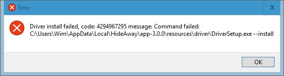

I installed HideAwaySetup3.0.0beta.
When starting HideAway 3.0 I got the following message.
See
I didn't uninstall HideAway 2.1.2.
Was that necessary?

Yes, HA2 needs to be uninstalled first. If you uninstall HA2, reboot the machine, then you should just be able to reinstall HA3 again.
If you do get the same error, then you need to uninstall HA3 (there's two entries in the Programs list for this), reboot, then reinstall.

Got the same Error Msg. - also after a "clean" deinstall + reboot ...
any other Idea ?

Try the steps posted here http://forum.firetrust.com/viewtopic.ph ... 51#p112523
Hopefully that kicks it into life

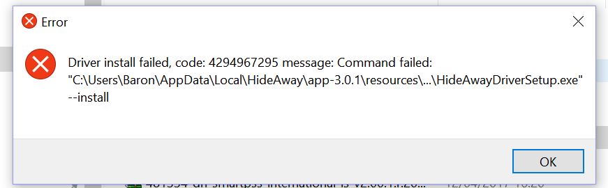

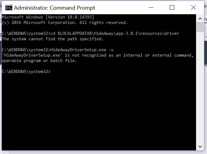

Hi everyone, getting exact same error message with Hideaway 3.0.1 and uninstalling and re-installing, rebooting and generally doing what everyone recommends but getting nowhere.
Running the scripts from the cmd prompt also ends in failure..
HW cmd.JPG (48.76 KiB) Viewed 16896 times
Any other suggestions? It appears to be looking for a driver.
I would add it worked perfectly until today..
Thanks...

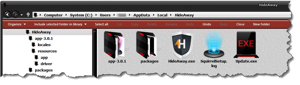

Are you seeing the HideAway folder, if you navigate manually to the following directory:—
If yes, are you seeing the following exact same contents in the HideAway folder:—

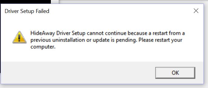

Curiously, a dialogue box popped up and said that installation could not be completed because the system had not been restarted since an older version was uninstalled, despite the fact that the 'system' in question has probably been rebooted many times since. This is something that is probably best understood by "experts" .. :bow

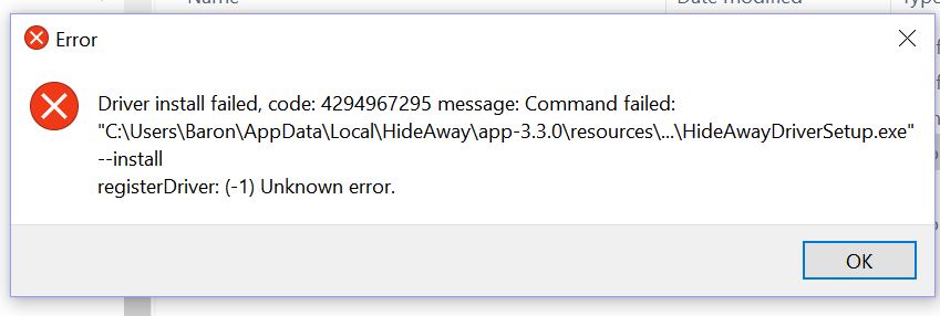

Er,except no it isn't (resolved). When to open it today, and the icon has just plain disappeared from my desktop! Honestly, I have never before come across a piece of software that works (or doesn't) in such a strange fashion. :scratch :crazy I did a search for Hideaway on Windows 10 search bar. clicked on the icon when it came up (hooray, it found it!) but had the dreaded (you need to restart after the last version was uninstalled) nonsense dialogue box. What the...? Of course I restarted. Couldn't find the software, just a driver. Downloaded 3.3 again to be greeted by my old friend: THIS.
Shall I give up with this and assume I made a poor purchase? :help
and error msg (slightly different. Image attached)

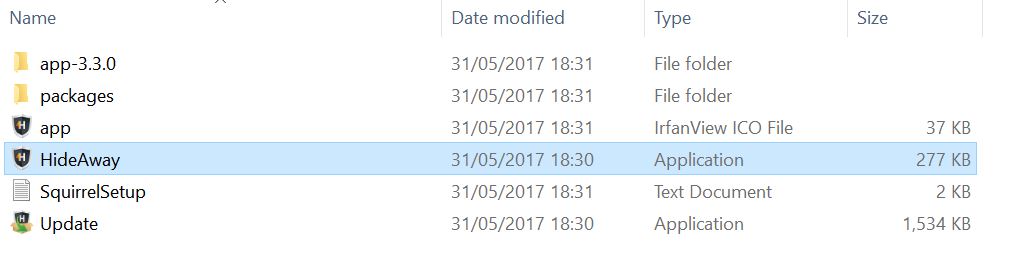

Confirm folder contents identical with yours posted.. (image attached)

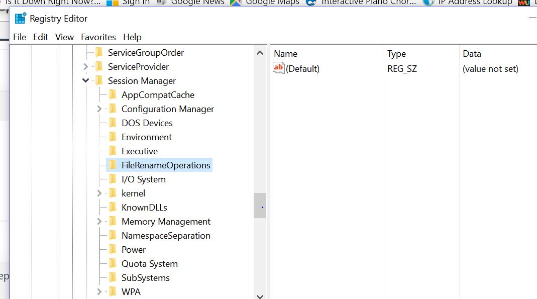

Download the full offline 3.3.0 installer (just keep it handy.)
Next, run RegEdit from an elevated command prompt and navigate to the following key:—
  • [HKEY_LOCAL_MACHINE\SYSTEM\CurrentControlSet\Control\Session Manager]
If you find a PendingFileRenameOperations key, just rename it to OldPendingFileRenameOperations — now, (without rebooting the system,) perform the installation using the (downloaded) offline 3.3.0 installer.

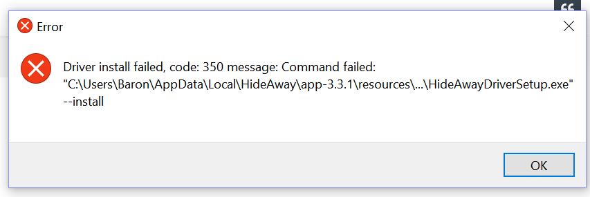

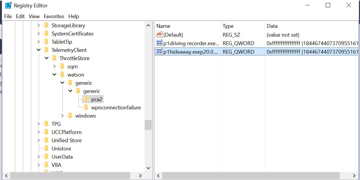

Sorry, more of same.
1.Registry Snapshot, your folder not present:
2: Following install attempt our old friend:
3. A reference to HW I found in the registry if this is any help.
4. I had the usual prompt to reboot:
So another complete fail.
In answer to your statement regarding 'beta stage' I did originally pay full price for Hideaway..so I 'trust' you can persevere and help me fix this thing.
