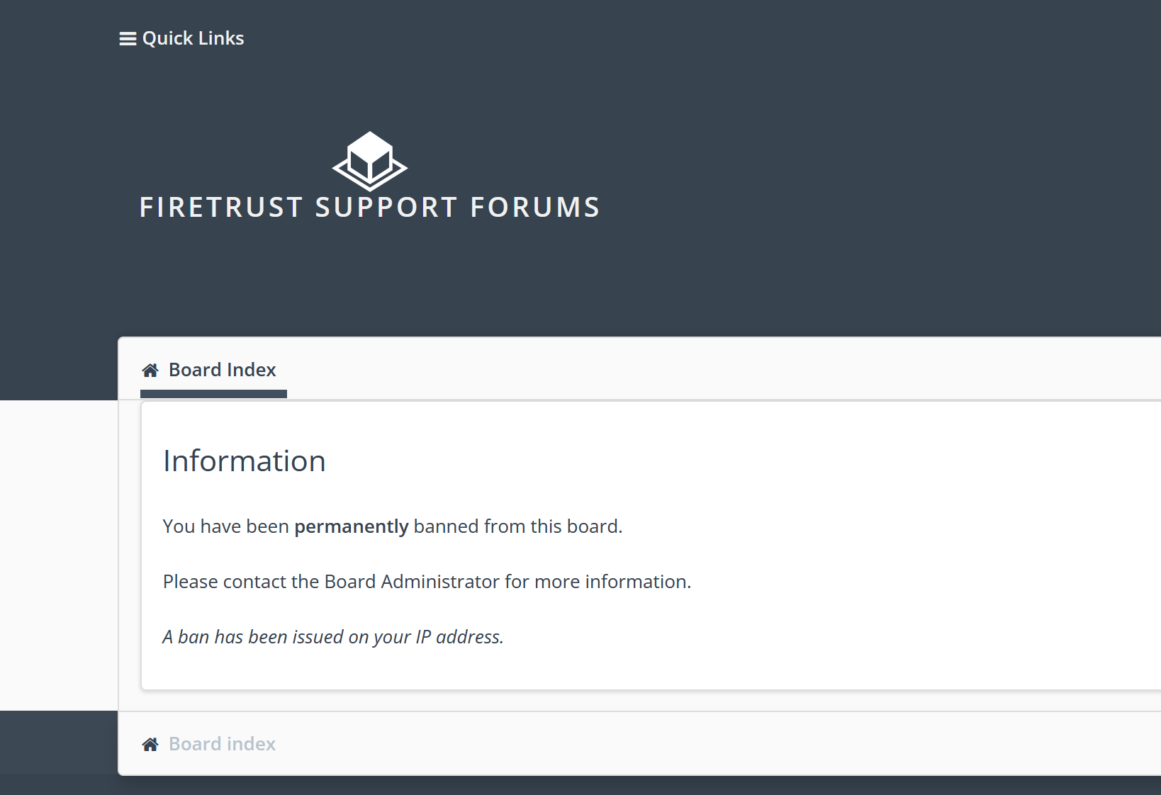

Finally, I have had to disconnect HA to be able to access this forum. When HA was connected, I got a message saying my IP had been permanently banned.

Oh, what's your IP and also the location you were on with Hideaway? We'll get that looked at.

That 192.. address is a local address on your computer. If you visit something like ipinfo.io/json it will tell you your public IP

82.126.68.29

Ok, can't see it being banned - but it might have just been an automatic but temporary security thing with the forum when switching IPs.
