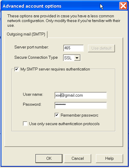

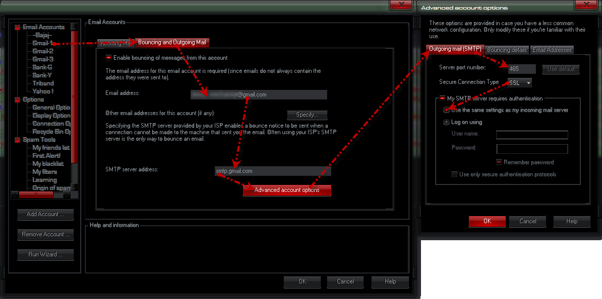

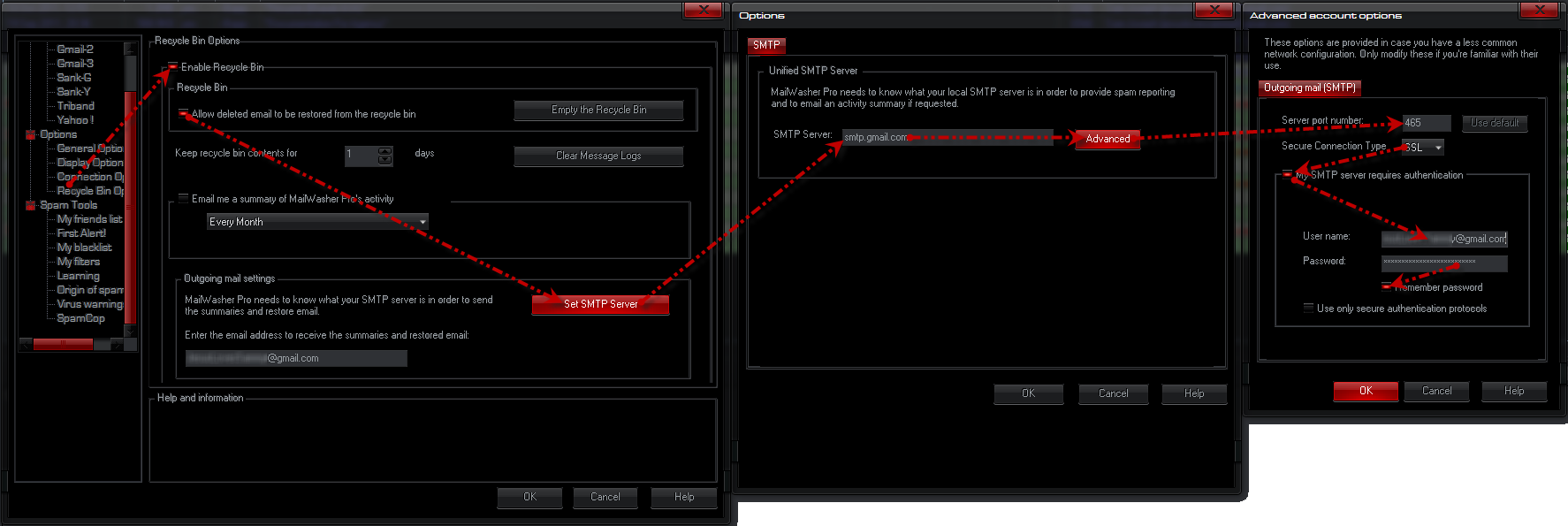

I'll second the Gmail SMTP method, fought this problem too many times when it turned out to be a stupid configuration problem with the mail server that the admin refused to fix. You don't need to actually use the Gmail account for anything else and it is free. Since you are sending the message and Comcast is accepting it there is nothing more you can do at your computer except try a different server.
Gmail Settings:
http://forum.firetrust.com/viewtopic.ph ... 313#p22313
Gmail Settings:

@ chl2001 & marzekiel
This is what works for me on Gmail - you may like to match notes . . . . . . . .
- Check whether your Recycle Bin options are right
- Recylce_Bin.png (138.47 KiB) Viewed 22494 times
- Check whether the SMTP options of your account are right
- SMTP_Settings.png (107.5 KiB) Viewed 22495 times
