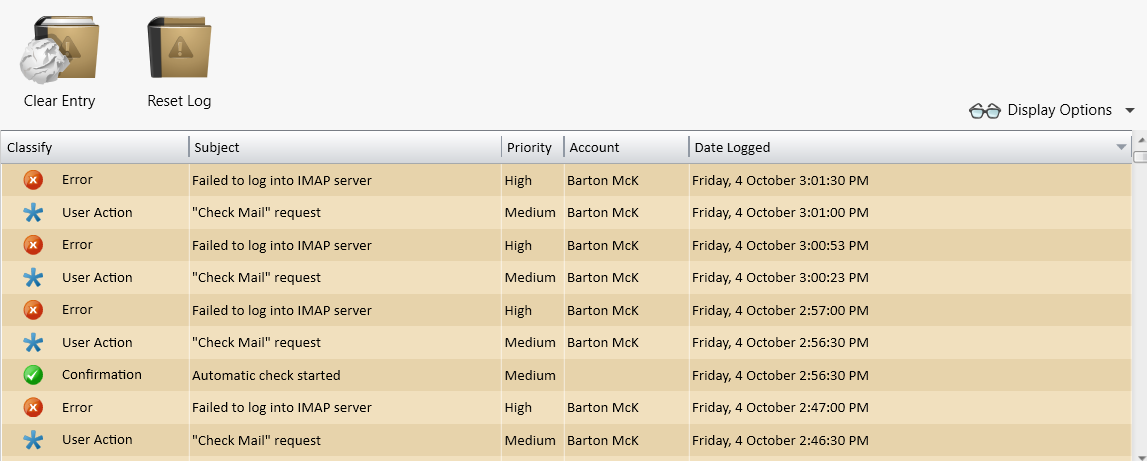

Hi, I am very new to MailWasher.
I installed the trial (v7) to help catch and flush phishing emails mainly for my outlook account (MS). However, when I run it nothing happens and it says there is no Spam. Then when I launch Outlook, the Spam/phishing emails show up.
So, just now I looked at the errors log and found the following (see the screen cap to follow). Everything in settings looks good to me, and when I click on "Check Mail" I get what appear to be valid messages for login and then "Default Mail checked in the last minute".
But clearly it is not working.
When I set it up I got a message saying that login was successful and I have checked the credentials. But clearly something is wrong.
Any suggestions on how I can resolve this or at least find the problem?
MailWasher errors Oct 4 2024.png (61.5 KiB) Viewed 2379 times
Thanks for any help.
B.

Hi, I did set it up with OAUTH and just checked again. I also looked at the MS article mentioned at the link you shared, but no joy. Something is still broken.
I have Outlook running in iOS and there I needed to set up FaceID to open the Outlook app (which is fine) and that has to be linked to a passcode, which is also fine. I can't think why, but perhaps this is somehow making MS think I need MFA? I don't use MFA to get into Outlook online or on my PC client however, but I do use login credentials - which are the same as those I entered into MW.
Anyway, still stuck. Thanks.

Great, thanks for those logs, and yes, please change to the incoming server:
outlook.office365.com
If no better, delete the problem email account first:
Settings>>Accounts, click the account>>Remove Account.
Click File>>Exit to close MWpro, then re-open it.
Then setup the account/s again exactly as per below directions:
In Mailwasher Pro click, Settings>>Accounts>>Add Email Account, type any name for this account you like, enter your email address and click Save.
Click the Incoming tab and click "Sign in with Microsoft", follow the prompts and you'll be asked for permission to allow MW access to the account, ensure you agree to this.
If it shows successful, click Save again on the outgoing tab, refresh folders on the IMAP tab (IF asked) and you are all set.
Please let me know how it all goes....
